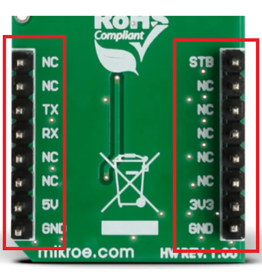

An example of CANFD transceiver module: https://befr.rs-online.com/web/p/communication-wireless-development-tools/1360823
It's is using MCP2542 transceiver. datasheet: https://ww1.microchip.com/downloads/en/devicedoc/20005514a.pdf
Thanks for pointing that out @mƎALLEm .  I had already found that, but there's mikro click connector on the mentioned boards.  I was hoping to find a shield I can just plug in?
