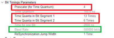

I've attached CubeMx project for STM32L4A6ZG: clock at 80Mhz, CAN bitrate at 500kb/s with reasonable parameters:
You can do the same thing for STM32L4R5ZI.

So I'm attaching the screen shot of the clock config.
