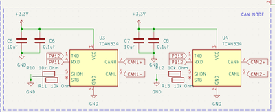

Yes but need to provide more details about the HW.
Is is the same transceiver used for CAN1 and CAN2?
Need to provide more details to have full picture to help you efficiently.

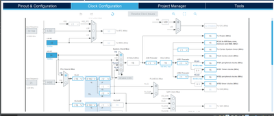

PS: I don't see issues with Filters config.
Except the fact that you are using HSI as source clock for CAN in NORMAL mode.

2024-09-11 2:26 AM
here are my transceiver circuits on the shield.
And here is my clock configuration, I use HSI as a clock source.

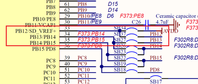

Could you please change the CAN2_Rx/Tx pins from PB12/PB13 to respectively PB5/PB6.
I have a doubt regarding the solder bridges config:
