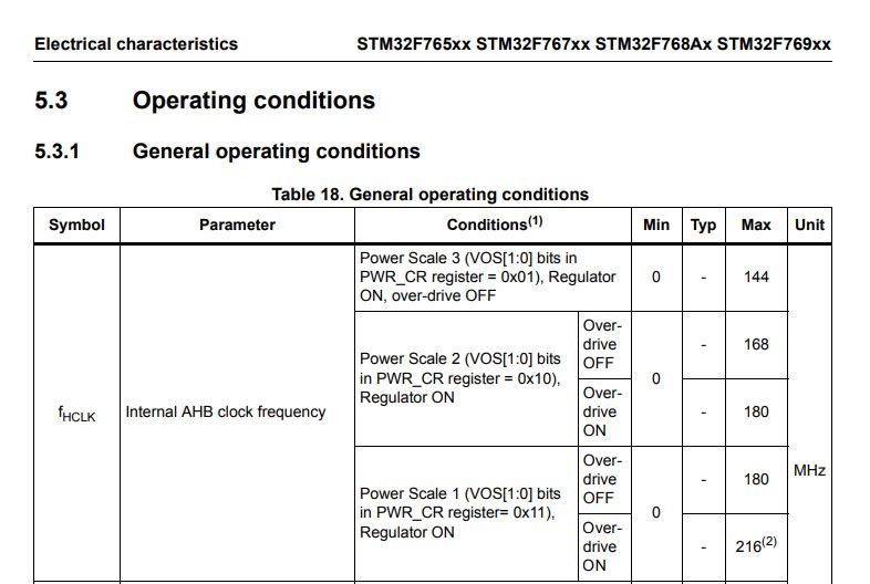

I am using STM32F746
I want to check if it can be used at 216MHz when using at 1.8V.
There is some confusion on the data sheet that makes it difficult to determine. (Attachments)
Please help me ~

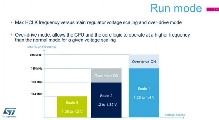

STM32F7 MCUs offer three voltage scales:
By passing the voltage regulator, power can be saved at both 3.3V and 1.8V.
I recommend you to refer to this AN4749 Application note Managing low-power consumption on STM32F7 Series microcontrollers.

And again ST's employee is not even able to understand what the question is about. It's about VDD not core voltage!
2020-02-11 2:00 AM
Table 18 suggests that the maximum is 180 MHz and overdrive must be off, which sounds sane. ST should know better, if their support will understand the question...
2020-02-11 4:22 PM
Yes, as Piranha said, I asked if it was possible to use 216MHz when the VDD voltage was 1.8V.
Can you give me a clear answer on this?
Thank you,
Best regards.
Gyosun.

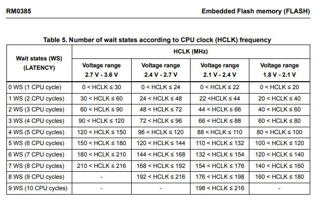

Hello @sim20 ,
You will find more clarification in the following tables :
I hope that is clear now for you.

2020-02-12 5:06 PM
hello Imen,
As a result, when VDD is 1.8V, it can only be used up to 180MHz.
Thank you for answer.
Best regards.
Gyosun.
