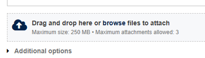

Hi
How Can I attach project in reply
2024-12-23 9:07 PM

2024-12-24 12:18 AM - edited 2024-12-24 12:20 AM
@Ash1 wrote:
Hi
with drag and drop feature:
