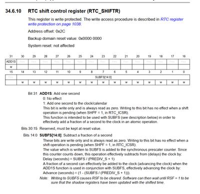

Subseconds register cannot be written directly, that's probably the reason why the HAL function does not write it (and clearing it is consequence of setting the RTC to INIT mode needed to set date/time).
Shift is the way to go. As RTC_SHIFTR is a write protected RTC register, and Cube/HAL probably keeps the RTC registers locked, you need to follow the "unlock" procedure as outlined in RTC.
There may be a Cube/HAL function to do this, I don't use Cube.

This is not trivial to pull out absolutely correctly.
The shift works by adding the value by which you shift, to the current value of SSR register.
As SSR is downcounter, after you set time, it contains a number equal or just below the synchronous prescaler. If you add a value at that moment, the resulting SSR value is larger than the prescaler, and your calculation
fraction = ((float)(hrtc.Init.SynchPrediv - subsecond) / (hrtc.Init.SynchPrediv + 1)) * 1000;overflows (subsecond is defined as uint32_t, thus the result of subtraction is a value slightly below 0xFFFF'FFFF -- btw. this formula results in implicitly using double which is probably not something you'd want), and the result overflows the range of the fraction variable, so the compiler is free to return whatever value in it (or to do anything else including a crash)).
You may want to print out the raw value of subseconds.
Btw. the Cube/HAL function reading the time reads subseconds, too. Also, don't read subseconds register just like that, as that locks the time/date and subsequent read then may return a surprisingly older value.

Thanks @waclawek.jan for pointing me in the right direction. I first got rid of "double" in the intermediate calculation step (although this was a non-optimized testing code).
I have researched the HAL_RTCEx_SetSynchroShift function plus the RTC_SHIFTR and successfully subtracted a fraction of a second: the RTC subsecond counter is a downward timer and the shift register can add a certain value to the timer (delay the RTC subtracting a second fraction), so if the current RTC subsecond value is lower than the value you want to set, the difference is passed to the SetSynchroShift to achieve the change.
Date: 03-10-2024, Time: 11:12:14.714 (subs: 72)
PPS
Set to 25ms (subs 249)
Add 195 to current 54
Adjusted RTC to exact millisecond from GPS time (025 ms)
Date: 03-10-2024, Time: 11:12:14.089 (subs: 232)
Date: 03-10-2024, Time: 11:12:14.195 (subs: 205)However, in order to advance the clock adding a fraction of a second, a full second needs to be added to the RTC using ADD1S bit and then subtract a fraction. I've tried it in a couple different ways with no luck. For me it's unclear which value I need to write into SUBFS. For example, if the current value of RTC subsecond is 127 and want to set it to 100, the SetSynchroShift will get value ADD1S and:

Add 1s and set to 25
Adjusted RTC to exact millisecond from GPS time (899 ms)
Date: 03-10-2024, Time: 10:30:09.808 (subs: 48)
Date: 03-10-2024, Time: 10:30:09.914 (subs: 21)
Date: 03-10-2024, Time: 10:30:10.019 (subs: 250)
(3: overflow)
Date: 14-10-2024, Time: 11:12:13.699 (subs: 76)
PPS
Set to 825ms (subs 44)
Add 1s + 250 (256 + 44 - 50) to current 50
Adjusted RTC to exact millisecond from GPS time (825 ms)
Date: 14-10-2024, Time: 11:12:14.4294967295 (subs: 291)
Date: 14-10-2024, Time: 11:12:14.4294967295 (subs: 264)
Date: 14-10-2024, Time: 11:12:14.070 (subs: 237)
Date: 14-10-2024, Time: 11:12:14.175 (subs: 210)
In the end, I'm still stuck because I have a code snippet does work only half the times (when the current millisecond value is higher than the one I want to set).
Let's see if we can make the last part work.
Regards, Bruno
2024-10-14 5:42 AM - edited 2024-10-14 5:43 AM
3. is correct (except that there appears to be some delay, probably due to using printf?)
Verify by comparing to the precise time source after adjustment.
Overflow is only temporary and it's in your time calculation, so just ignore it for that max. 1 second after time adjustments. You could also subtract the correction to the calculated time
=> before calculating milliseconds and displaying time, perform:
if (SSR > 255) {
SSR = SSR - 256;
subtract_one_second_from_time();
subtract_one_second_from_time() {
if (seconds == 0) {
seconds = 59;
if (minutes == 0) {
minutes = 59;
if (hours == 0) {
hours = 23;
subtract_one_day(); // and this is tricky
} else {
hours--;
} else {
minutes--;
} else {
seconds--;
but that gets nontrivial around midnight as you'd need to adjust the rollover to date too.
