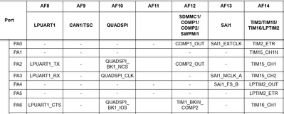

I have used GPIO_AF14_TIM16 in the GPIO configuration, since the datasheet in the manual contained the following table: https://imgur.com/a/BwVqaxh, I'm not 100% sure that it's correct though.
Does someone have an idea on what I'm doing wrong here?
