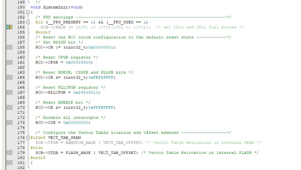

STR R1, [R0] And now, instead of blinking the LED at 1sec rate (adjusting the delay), the processor ignores everything (like, skips all the code) and suddenly goes to SystemInit() when reaching the end of code
And does nothing more after this. Never saw anything like that, maybe I misconfigured something?
2018-12-08 1:44 AM
Now this is strange: you write assembler yet don't single-step in disassember window?
2018-12-08 6:29 AM
That's not very efficient. The Assembler is not going to fold that, you need to condense it manually. You should be able to perform a single masking AND, followed by a single OR.
You understand __main != main right?
The Reset_Handler code typically calls SystemInit() prior to calling __main, which in normal implementation initializes the statics and then calls to main()
Perhaps uniquely name your routine, and call THAT from the Reset_Handler, and not the other components.

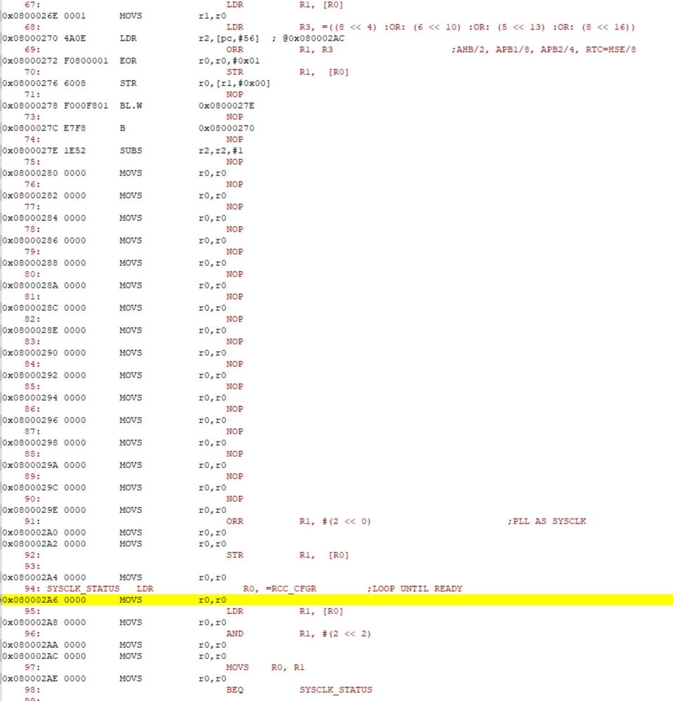

But, there's something wrong with the PLL switch, after the instruction to change the system clock, almost everything in the disassemble view turn MOVS r0,r0 and bugs.
I tried to reduce the clock below 216MHz, used 20 NOPs after changing the prescalers, but still nothing. The only way it worked was to divide the AHB by 8, but resulted in a clock less than 16MHz (from the blinking rate).

2018-12-08 1:43 PM
The flash needs to be configured to the number of wait-states the new clock will need.
2018-12-08 4:52 PM
That was the solution! Thank you very much!
