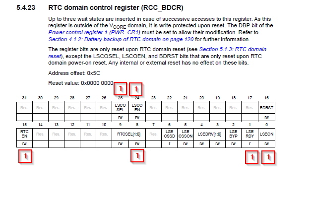

2022-04-22 5:00 AM
The RCC_BDCR register is configured as follows:
0x03008103
