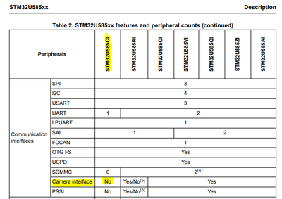

Hello @LuizF_Ferro ,
The camera interface (DCMI) isn't available in STM32U585CI as mentioned in the datasheet table 2. . STM32U585xx features and peripheral counts.
If you want to use DCMI interface, I recommend  you to refer to table 2. and to choose an STM32U585 which supports DCMI like as STM32U585OI, STM32U585VI,.....
