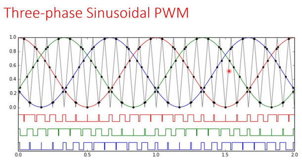

@Community member​ , with SPWM I mean Sine-Pulsed Width Modulation (https://ieeexplore.ieee.org/abstract/document/5489272), the kind of modulation which varies its duty ratio following a sinusoidal function and which is the result of compairing an up-down carrier with a sinusoidal signal. If the same carrier is compared with three sinusoidals phase-shifted 120º, the result is a three-phase SPWM able to control a 3-phase power converter. The signals are presented in the following picture:
0693W000008x5FfQAI.pngI've found out that TIM1 and TIM8 are suitable exactly for that kind of modulation, since the counter does the carrier shape, and the comparators of each channel CCR1, CCR2 and CCR3 can be a sinusoidal function with an arbitrary amplitude and frequency.
Thank you all for your help!
