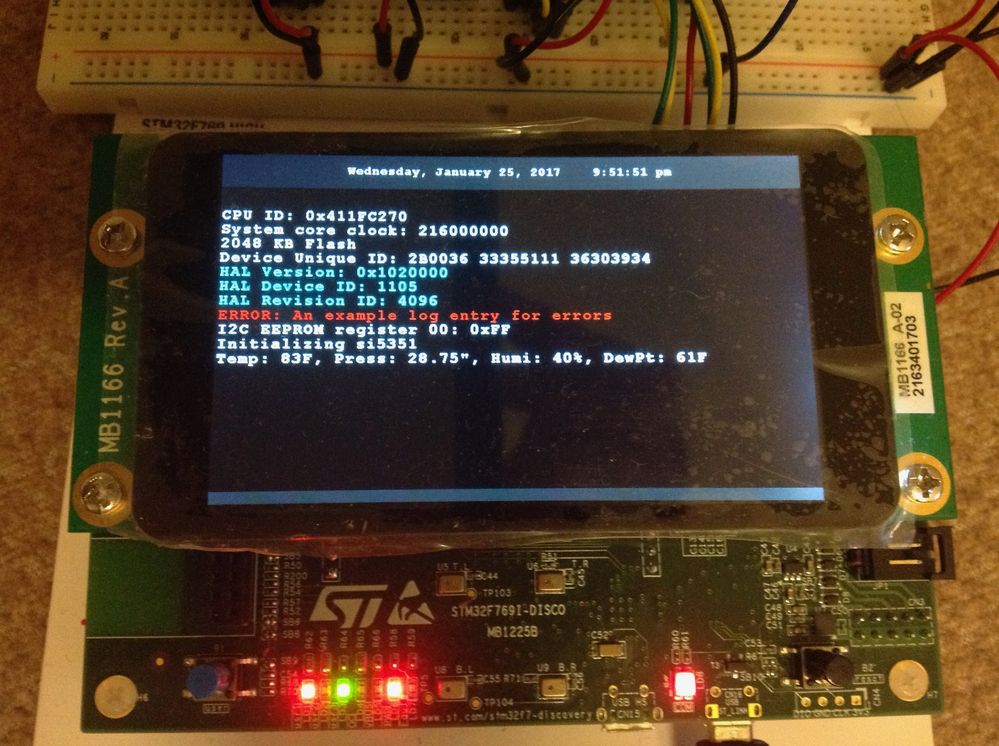

It was easy enough.
I copied the BSP directory from STM32Cube/Repository/STM32Cube_FW_F7_V1.6.0/Drivers/BSP/STM32F769I-Discovery/ into the Drivers/BSP directory of my project. Added that folder to the includes search path
Then I copied the Utilties folder from STM32Cube/Repository/STM32Cube_FW_F7_V1.6.0/Utilities/ into my project, and added it to the includes search path
I used STM32CubeMX to generate code with only the default settings except for the clocks, and what I wanted turned on, which was i2c, spi, uart, and a couple of timer/counters.

, RCC_OscInitStruct.PLL.PLLQ = 4,If you're going to use the SDRAM, the documentation says don't go faster than 200mhz so change the PLL M from 432 to 400 and you will get 200mhz sysclock
Then I added ♯ include ''stm32f769i_discovery.h'' and tried to build. I let the linker tell me which HAL driver files were needed one by one. Added them to Drivers/STM32F7xx_HAL_Driver/Inc/

stm32f7xx_ll_wwdg.hI'm sure some got added that didn't need to be because I just did some basic pattern matching and was being lazy. don't forget to add the corresponding .c file to the Src folder. Don't just copy *.c because some template files will get copied raw and your build will probably fail.
The whole board support package, with being able to print to the screen, has these includes:
♯ include ''stm32f769i_discovery_sdram.h'',
♯ include ''stm32f769i_discovery_lcd.h'',
♯ include ''stm32f769i_discovery_qspi.h'',
♯ include ''stm32f769i_discovery_ts.h'',
♯ include ''stm32f769i_discovery_audio.h'',
♯ include ''stm32f769i_discovery_sd.h'',
♯ include ''stm32f769i_discovery_eeprom.h'',
♯ include ''lcd_log.h''Ok now that the includes and source files are in place, we have to turn the modules on. Keep a copy of this file because there's no place for USER CODE in it and the STM32CubeMX will clobber it if you generate new code.

, ♯ define HAL_CORTEX_MODULE_ENABLEDand that's how i got the BSP working on my STM32F769I-Discovery using SW4STM32.
