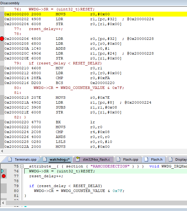

I ran some tests (don't trigger the watchdog from my mainloop) and i jump into the irq handler and can extend my watchdog window. so i think in principal this code works and the movment to RAM was successful.
but as soon as i start to erase a sector the watchdog retriggering does not work and i run into the watchdog reset.

Oh, i use an stm32f407 and this is my scatter file which is more or less the Keil example
LR_IROM1 0x08010000 0x00070000 { ; load region size_region
ER_IROM1 0x08010000 0x00070000 { ; load address = execution address
*.o (RESET, +First)
*(InRoot$$Sections)
.ANY (+RO)
RW_IRAM1 0x20000300 0x0001FE00 { ; RW data
.ANY (+RW +ZI)
RW_CODE 0x20000200 OVERLAY 0x00000080 { ; RW data
*.o (RAMCODESECTION)
RW_TEMP 0x20000280 OVERLAY 0x00000010 { ; RW data
*.o (TEMPDATASECTION)

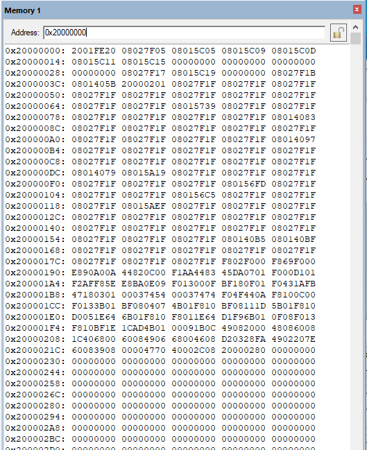

this is my interrupt vector table and as far as i can tell the wwdg handler points to a RAM location(the 0x20000201 address)
memcpy((void*)0x20000000,(void const*)(FLASH_BASE | VECT_TAB_OFFSET), 0x1FF); // Move Vector Table from FLASH to RAM
SCB->VTOR = SRAM_BASE ; /* Vector Table Relocation in Internal SRAM */

Remember the vector table also needs to be in RAM
