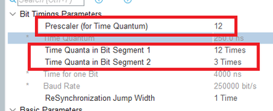

Just make a test with these CAN timing parameters:
Also is that possible to use CAN2 instead of the CAN analyzer (remove the CAN analyzer) and transmit CAN frames to CAN1 and see if you receive frames on CAN2 ("echoed" by CAN1)?

I changed CAN timing but there is no change in behavior. The board is still retransmitting. CAN analyzer is mandatory and can't be removed.
