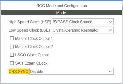

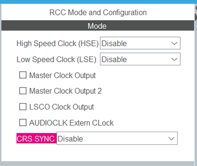

I first worked with CAN with STM32H563 with normal mode. It worked. Later Again I tried it is not working with same code. Loop back mode is working fine. I would like to use other pins for CAN since I am using PD0 and PD1. May I know which pins are good for working with CAN. Please find the attached code and let me know if there any issues in the code.

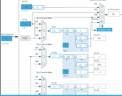

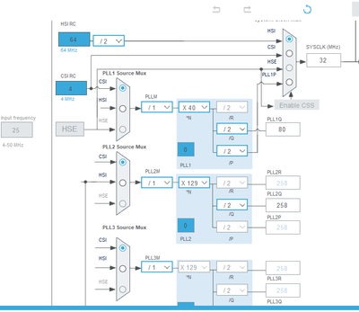

What clock source are you using for the FDCAN? you need a crystal for CAN communication.
I have tested the same with STM32H533RET the CAN protocol, It worked fine without the external crystal oscillator.
I made the PLL1Q to 80MHz which is the input for the CAN protocol.
Please let me know if i have made any issues with the clock settings.

2025-05-20 12:16 AM - edited 2025-05-20 12:57 AM
As you told, I tested the board stm32H533RE Nucleo board with the external crystal of 24MHz. I configured the CAN peripheral to 80 MHz and checked with PCAN view. It worked successfully. I can able to send and receive the data. But when I configured the clock peripheral to 150 MHz, I could not see the data in the PCAN view. (Please Note: Both are configured to 500Kbps with prescalar and Time segments).My question if I configure my clock frequency to 150MHz, Will the classical CAN works. Thank you for your support. May i know where can i find the example project for stm32h533RE or any links might be helpful
