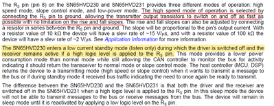

Also check the Rs pin voltage level of the transceiver:
From its datasheet:

When you are using a chip and you face an issue you need to start with looking at its datasheet as you may find some answers there.
You are using SN65HVD230 transceiver: datasheet at this link: https://www.ti.com/lit/ds/symlink/sn65hvd230.pdf?ts=1703754810632&ref_url=https%253A%252F%252Fwww.google.fr%252F
Now, regarding your question about Rs pin. This is it: (look at the datasheet page 5)
This is the Rs pin description in the datasheet:

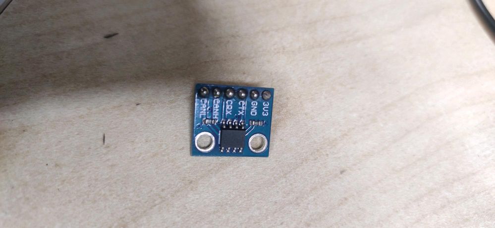

Thank you @mƎALLEm for your guidance. I was able to fix the issue by simply changing the voltage supply to 5V to the transceiver. Earlier I used to supply 3V to the transceiver. This is the transceiver I am using. It has no Rs pin to it.Transceiver

But according to the datasheet it's a 3.3V transceiver! Are you sure? or are you using another tranceiver?
https://www.ti.com/product/SN65HVD230
2024-01-02 8:25 PM
I am also curious about how its working.I have attached the photo of the transceiver which is bought from amazon I think its the counterfeit one.
2024-01-03 12:18 AM
The picture is not sufficient as it des not provide any information. The schematics of the transceiver module is needed.
2024-01-03 12:54 AM
I don't have a reference to any other schematic other than the schematic present in the datasheet by Texas Instrument. I have only one the Texas Instrument datasheet.
