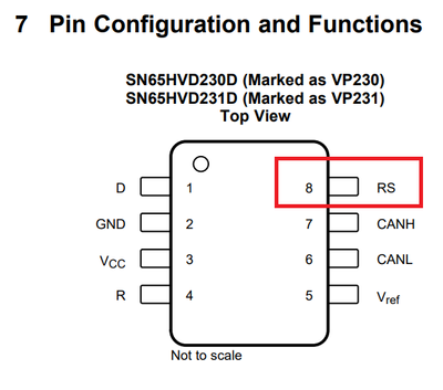

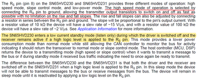

When you are using a chip and you face an issue you need to start with looking at its datasheet as you may find some answers there.
You are using SN65HVD230 transceiver: datasheet at this link: https://www.ti.com/lit/ds/symlink/sn65hvd230.pdf?ts=1703754810632&ref_url=https%253A%252F%252Fwww.google.fr%252F
Now, regarding your question about Rs pin. This is it: (look at the datasheet page 5)
This is the Rs pin description in the datasheet:

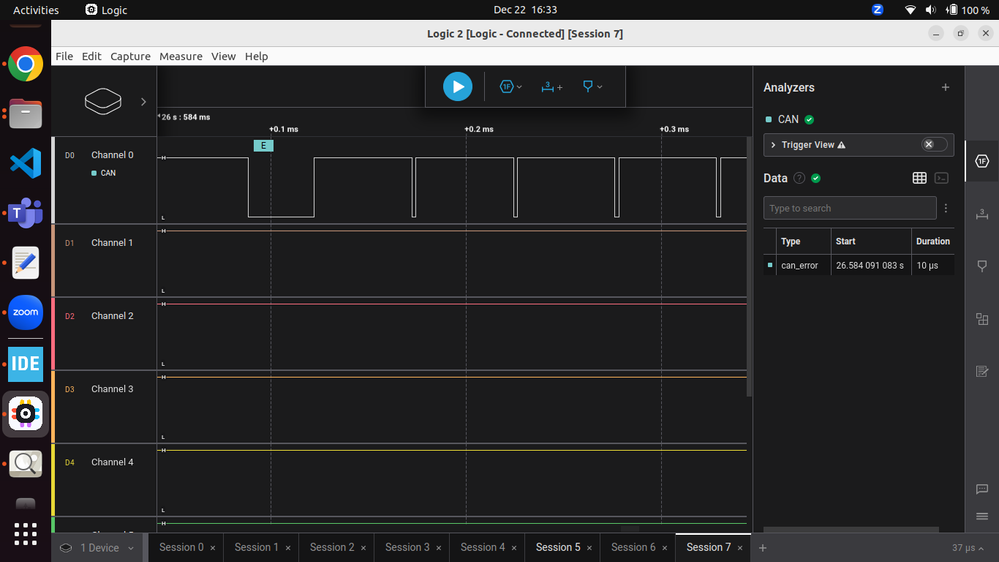

2023-12-26 9:28 PM - edited 2023-12-26 9:30 PM
This is the waveforms I am getting by connecting logic analyser on the CAN_Tx pin.
2023-12-27 12:26 AM - edited 2023-12-27 12:27 AM
First, provide more details about your bus connections. Did you connect a second node on the bus to communicate with your board?
Second, please provide your schematics.

Please provide more details on your configuration as requested. The waveform does not help.

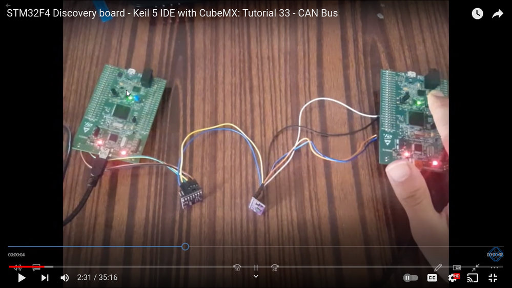

2023-12-27 1:15 AM
I am referring this connection to set up the CAN bus
