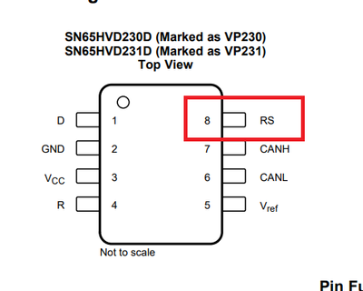

2- Also did you pull the Rs pin of the transceiver down (connected to the GND)?
The hardware must be 100% OK to establish a good CAN communication.
