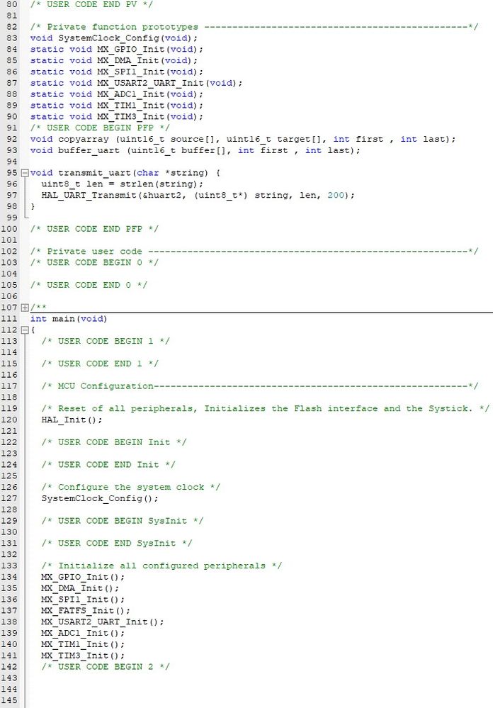

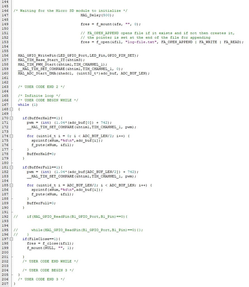

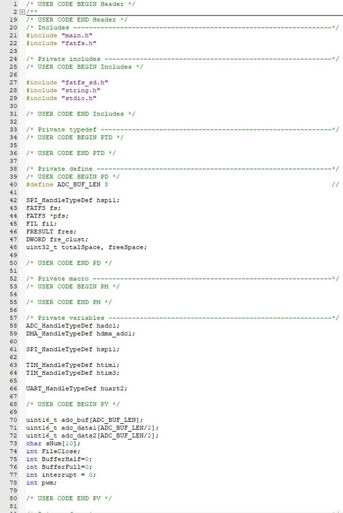

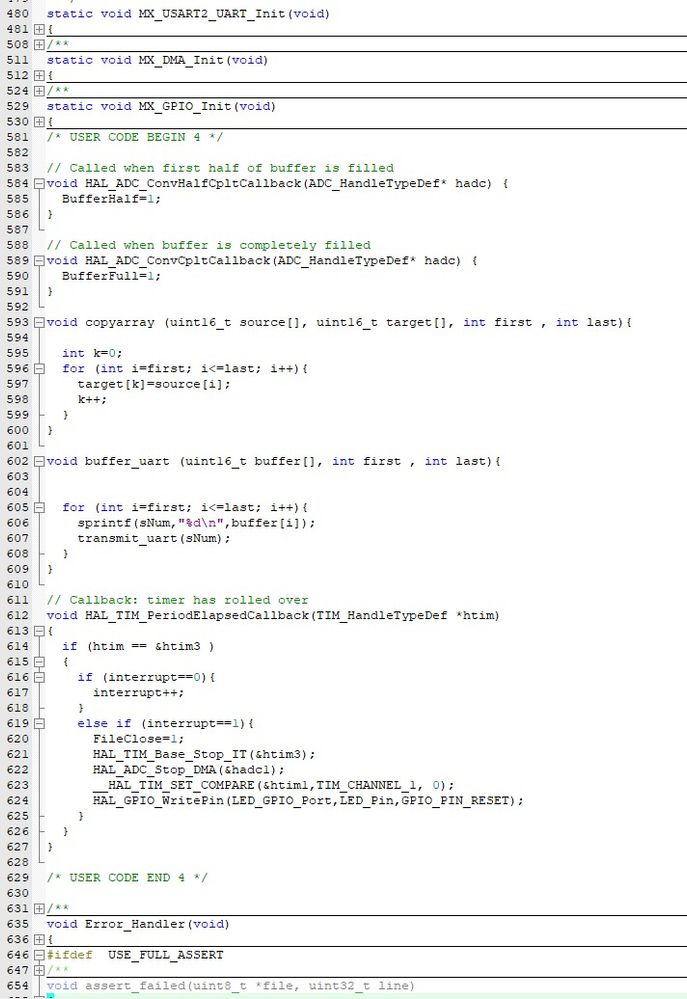

Thank you for answer. Yes, when I tried I used DMA and buffer. When half of the buffer was fulled, data sent to the sd card module with SPI protocol. But, when the half of the buffer data was sending to the sd card I lost the data. My code is below. Thanks in advance!
