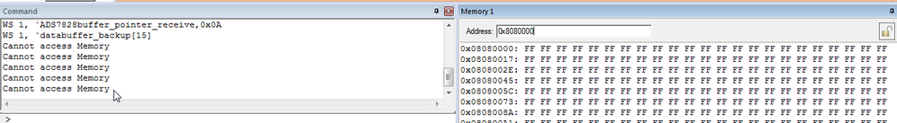

by the way a small trick to decide the flash available to use is trying to view the flash at the time of debug. If you set a flash addr not available, there is error popup. In this way it is easy to figure out the real space available. For example the chip stm32f411ret6 has a flash space of 512k, the last address is 0x8080000-1. When I put 0x8060000 or 0x8070000, it has no problem. If I put 0x8080000, it has problem, as the picture below. Definitely it is RET6 instead of RCT6 chip.
