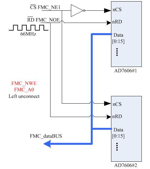

Thank you rygelxvi, the highest freq is 216MHz, i got it wrong.
Now i take the parallel way to process, fmc is configured to NOR flash mode?with one chip-select FMC_NE1, one FMC_NOE,one FMC_NWE, one FMC_A0 and 16bit data bus FMC_[0:15]: 1. FMC_NE1 control two AD7606s, one of them take neg2. FMC_NOE as high speed read enable to AD's nRD pin3. Two AD share the data bus4. FMC_NWE and FMC_A0 left unusedI hope this will work2016-06-28 3:18 AM
You really need to look at the timings for the AD7606 and match it to the NOR operation for stm32 to understand if it will work or not. Make sure that all timing constraints in figure 4 are fulfilled. 66 Mhz will never work. I think you mean 33Mhz which is absolute maximum for the AD chip (t11).
