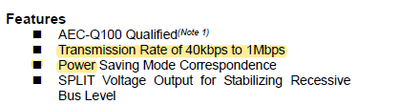

1- If you are using HSI as source of clock please change it and use STLINK-MCO as source clock (precise clock) and configure HSE in bypass mode.
2- According to the transceiver datasheet it cannot exceed 1M/s as CAN bitrate. So if you are exceeding this bitrate with FDCAN you will surely face issues.

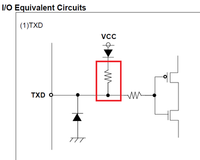

Another important point to consider:
From your tranceiver datasheet: it's a 5V one (VCC Min: 4.75V, Max: 5.25V)
If I consider you supply it with around 5V, you have an issue with TxD pin minimum 'High level input voltage':
VIHmin = 0.7 x VCC = 3.5V > IO voltage level provided by the STM32G0 pin (@3.3V).
Even with VCCmin: VIHmin = 0.7 x 4.75 = 3,325V really at the limit!
2023-11-08 7:06 AM - edited 2023-11-08 7:07 AM
What would be your suggestion to overcome this problem?
2023-11-08 7:14 AM - edited 2023-11-08 7:22 AM
Simply use 3.3V transceiver or use voltage level shifter for the final project.
But for testing I think there is an internal pull-up resistor connected to the transceiver TxD pin:
Try to configure CAN_Tx pin in Open Drain. But I cannot guarantee this workaround.
