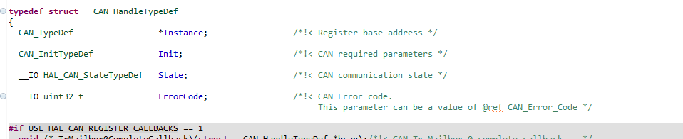

Hi im trying to develop a bit of error management in my canbus driver.
I noticed there is an ErrorCode inside the canbus structure.
That error code could have any of these values:

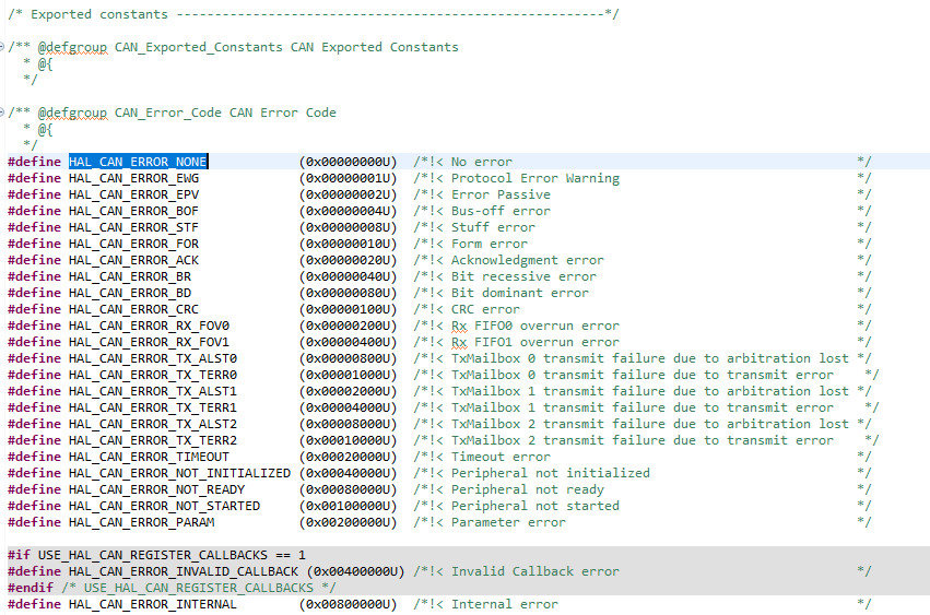

But it turns out the hcan.ErrorCode is always HAL_CAN_ERROR_NONE, even if the canbus is not plugged to anything wich should give any of these:
//#define HAL_CAN_ERROR_EPV            (0x00000002U) /*!< Error Passive   */
//#define HAL_CAN_ERROR_BOF            (0x00000004U) /*!< Bus-off error  */
 //#define HAL_CAN_ERROR_ACK            (0x00000020U) /*!< Acknowledgment error   */
Am i missing something out here? maybe something needs to be enabled somewhere in the HAL to get errors¿

Maybe i need to implement the error callback myself??
void (* ErrorCallback)(struct __CAN_HandleTypeDef *hcan);             /*!< CAN Error callback                    */
 and make it modify the hcan struct.ErrorCode

https://community.st.com/s/question/0D50X00009XkWlmSAF/stm32cube-fwl4-v1110-bug-in-new-can-driver
This helps, maybe i need to ignore HAL and use CAN_TSR register directly
