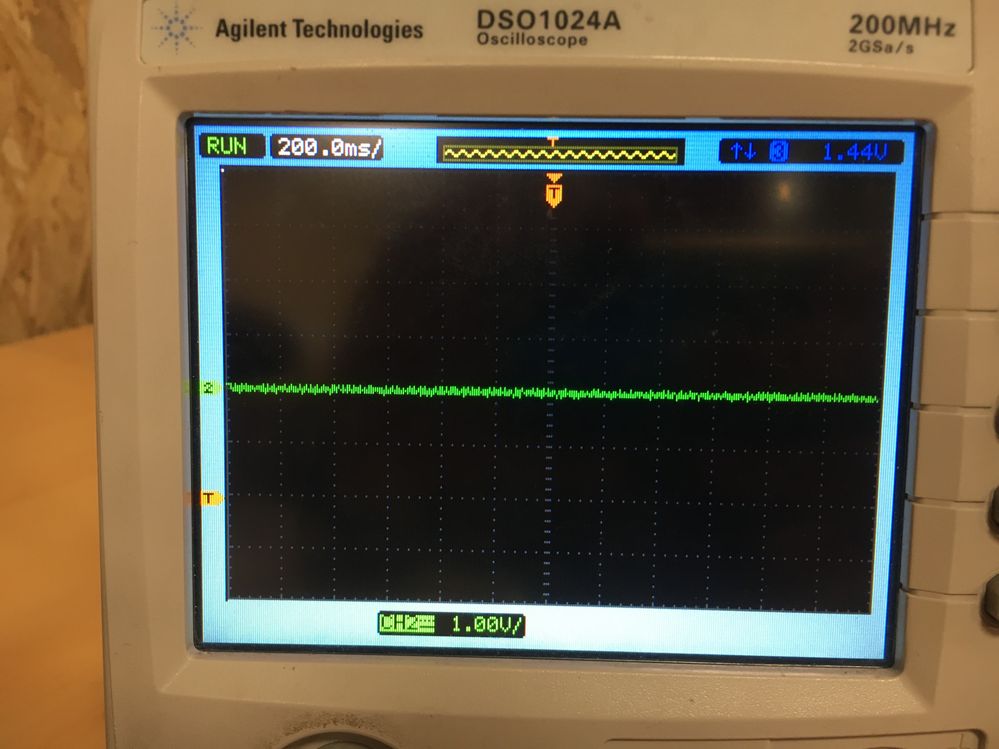

I use STM32F767ZI nucleo board and i'd like to use CAN to send data.
To begin ijust want to see the data frame sent on Can_Tx on my oscilloscope.
For this i just connect the Can_rx to the Can_tx of my nucleo board on PD0 and PD1 to see what happens.

/************************ (C) COPYRIGHT STMicroelectronics *****END OF FILE****/However when i check the CAN_Tx on the oscilloscope, nothing is send

CAn requires a minimum of two nodes to work. You also need a twisted-pair cable with termination resistors at each end. Connecting the TX and RX pins is NOT a CAN hardware loopback.
If you check the CAN status registers you will see TX errors and a bus disconnect in effect, which is why you don't see anything on the scope.

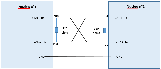

2020-07-31 5:20 AM
Here is the manip i want to verify
2020-07-31 10:44 AM

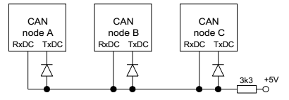

Your wiring to use CAN without drivers is wrong.
Look at: https://www.mikrocontroller.net/attachment/28831/siemens_AP2921.pdf
The CAN is not an UART!

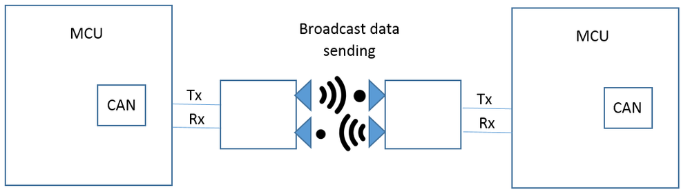

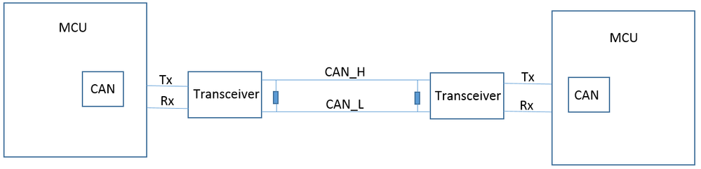

The goal of my project is to send data in broadcast.
In fact, today we have this system:
that we want to replace by this:
TO begin, i just want to generate CAN frame and verify the reception. Next, i'd like to include the broadcast module.

2020-08-03 4:53 AM
The CAN bus is a broadcast type of bus. This means that all nodes can “hear�? all transmissions.
If one node receive a correct message it will ACK this message.
If the message is not acked, probably the sender will retry.
The CAN bus timing is very tight.
For my information, what is the "broadcast module" you use ?

I'm going to test The Siemens CAN application with one data line.
This is a NEW module, which is not yet available on the market but it supports can application and so tight timming ^^

2020-08-05 1:41 AM
Hi everyone,
Some BAD news -_-,
I directly tested the wireless experiment :
PS: I connect a GND between the 2 MCU.
But nothing happens... no CAN frames sent on Can1_Tx on the scope.
I'm still waiting an order to test the SIEMENS CAN application without transceiver.
