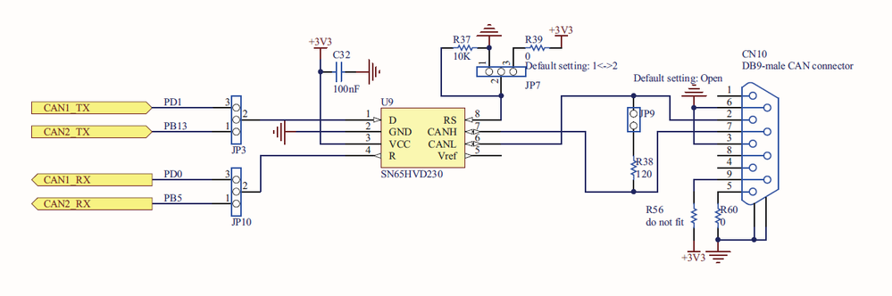

To use CAN you have to setup the HW:
From STM3240G-EVAL schematic:
For the CAN software you can refer to the example provided by STM32CubeF4 package under the path Projects\STM324xG_EVAL\Examples\CAN\CAN_Networking.

I've already provided the details: HW setup and a project example using CAN networking.
Use STM3240G-EVAL as reference.

STM3240G-EVAL board features a STM32F407IGH6 which is the same die. You can use it as a reference. Refer to the schematics in the Appendix A section "Schematics".
