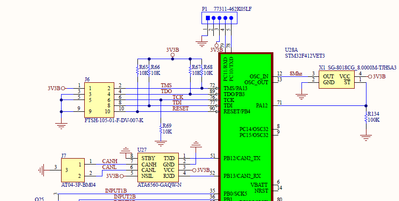

I have to assume that my transceiver must be the problem.

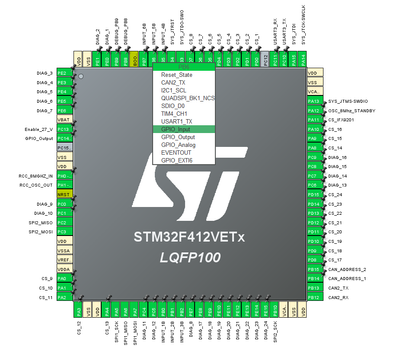

Can2 has another port pin but I think I selected the GPIO ports correctly.

Hello your the selection of ATA6561 doesn't present an issue.
But since you're not seeing any activity on CAN_Tx pin of STM32, are you sure about the GPIO config? are you sure you selected the correct alternate function that connects CAN_TX to the transceiver?
You need to start at this point ..You need at least to have an activity on CAN_Tx.

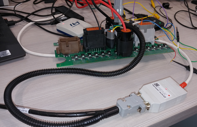

You haven't mentioned what you're trying to send a CAN message to? If you haven't connect your CAN wires to any other CAN bus, then you'll get transmit error.

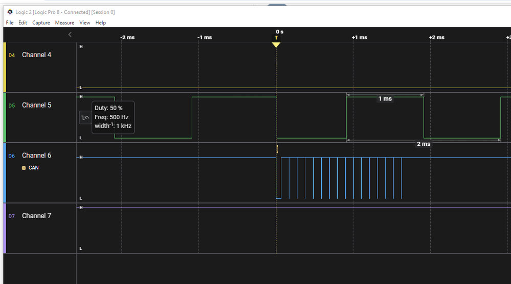

I have a Pcan Dongle hooked up and it is configured to 250Kbits per second and I have verified that it is working with hardware that is transmitting messages.
The bit rate is set at both places at 250 Kbits per second
Yes I am using the HSE as clock source.
The 1 ms clock tick is being generated from a PLL clock so I know the clocks are working off of the 8 Mhz clock
When I send the transmit message I get the CAN error on channel 6 Blue Trace.

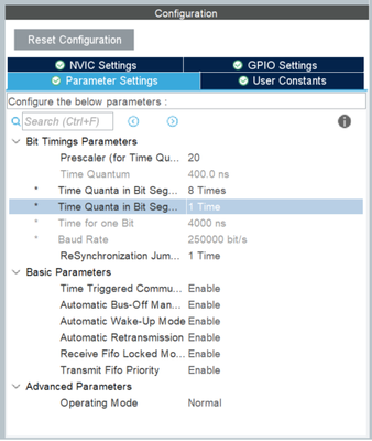

upload your ioc file
2024-03-15 6:19 AM - edited 2024-03-15 6:25 AM
Check also your connections and wiring by doing continuity tests.
What about the termination resistors? Is there a termination resistor inside the PCAN? I don't seen one on the schematics above! You need only two termination resistors of 120ohm on each side of the bus .
Could you please also provide a diagram of your connections including the perceivers and the termination resistors to have a clear view of your HW?

2024-03-15 8:10 AM - edited 2024-03-15 8:50 AM
You said you configured your PCAN at 250kb/s but from your ioc file the bitrate is set at 500kb/s!
Could you please double check? (changing the Prescaler (for time Quantom) to 8 instead of 4)
2024-03-15 8:21 AM
Based off your ABP1 clock, you'll need these settings for 250kbs
2024-03-15 8:49 AM
The 120 ohm terminator at the CANH and CANL side of the Transceiver is attached with soldering the wires to the (greeen and yellow wires).
There is a terminator in the PCan dongle as well.
