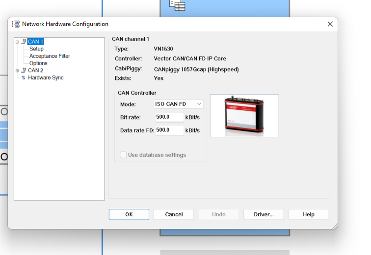

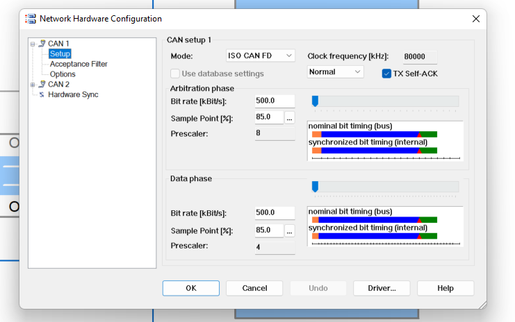

CANalyzer settings:
The data I'm sending from the CANalyzer:
Message ID: 0x123
Data Length: 8
Data: Alternates between 0x2233445566778899 to 0x1223344556677889 every 2 seconds
I'm unsure why this code is successfully sending data to the CANalyzer but not receiving the data sent from it.
Have I not configured the Rx properly?

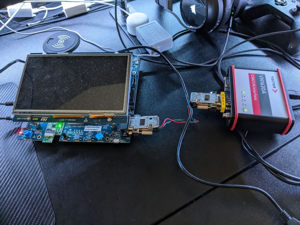

are you using a canbus transceiver?
show us a picture of your setup
2022-09-20 8:54 AM
Hello Javier,
Thank you for the response. I am using the built-in CANbus transceiver on the evaluation board. I am communicating to the CANalyzer via a DB9 cable, as shown in the picture. I have verified the wiring (since I am successfully sending data from the evaluation board to the CANalyzer)
2022-09-20 1:55 PM
Hello Javier,
