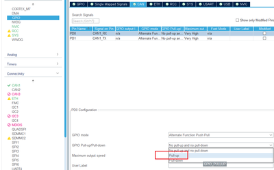

Second, set the internal pull-up on CAN_Rx pin:
Hope it helps.

2024-11-04 6:00 AM
Hello SofLit and thanks for the quick reply, it worked immediately.
