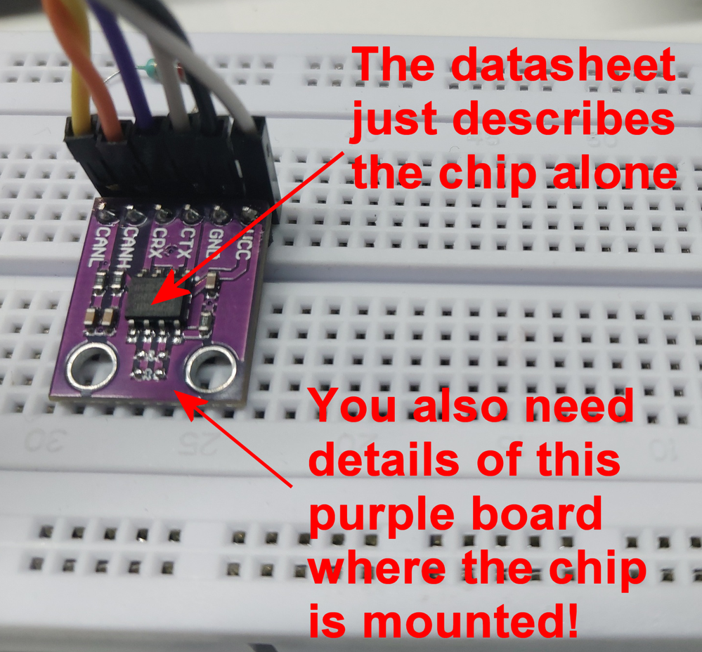

2024-04-12 4:32 AM
2024-04-12 4:45 AM
The datasheet only describes the chip itself.
We also need details of those boards ("modules") on which you have the the Transceivers mounted!
The schematic(s) for those boards will tell you whether they ground the Rs pin or not.

The RS pin is already grounded through a 4.7k resistor.
Show a diagram on how you've connected each of the pins on the CAN module to your STM32F407. Is this a custom board? Do the two STM32F407 have a ground reference between them or are they isolated from each other besides just the 2 CAN wires?
2024-04-17 6:02 AM - edited 2024-04-17 6:54 AM
According to the schematics? Do you have it?
