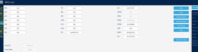

Then I made sure I'm in the bootloader from STM32 Programmer. That the PC (Program counter) in the Bootloader range (at 0x1FFF0000)
PC
And I followed the flow chart in AN2606, and AN3154(CAN protocol used in the stm32 bootloader).

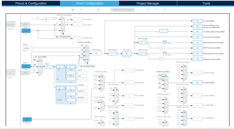

Hi Imen,
I’m working with the Nucleo STM32L433 and don’t have an external clock available. Do I need to solder on an external clock, or can I use the internal HSI? I’ve configured the HSI to run at 60 MHz and set the CAN baud rate to 125 Kbps.
