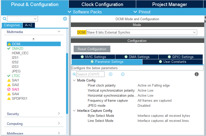

i am able to communicate TW9990 via I2C , Now i am facing issue to convert data YCbCr to ARGB8888. I am using CubeMX for code generation of DCMI. configuration is below in snap
I got a reference code from examples what it seems it tacking data in RGB656
**************code is below *******************

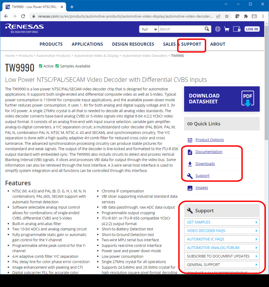

@Community member "i am facing issue to convert data YCbCr to ARGB8888"
That has nothing to do with the STM32 - the conversion would be exactly the same whatever platform you use.
Have you looked at the support available from the chip manufacturer?
"I got a reference code from examples"
Where, exactly, did you get that? Is it actually applicable to this chip?
EDIT
Have you studied this:

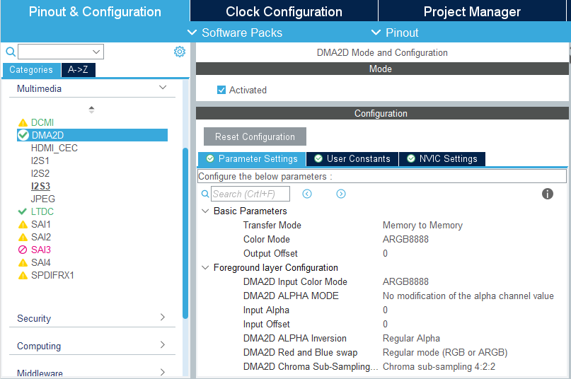

as JPEG Decoder example(stm32h743), it decode the jpeg buffer into YCbCr buffer and DMA2D_copy_Buffer () function convert YCbCr in to RGB.
in my project i tried start DMA of DCMI to get ycbcr output and pass the address of YCbCr buffer address to DMA2D_copy_Buffer () but i am not getting RGB output
if(HAL_DCMI_Start_DMA(&hdcmi, DCMI_MODE_CONTINUOUS,JPEG_OUTPUT_DATA_BUFFER, 0x0f00000)!=HAL_OK)
