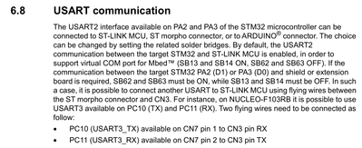

> STM32F446RE
So probably the NUCLEO-F446RE board?
What pins are you using? Are they connected to what is sending data to tera term?
