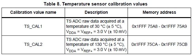

According to the data sheet, the calibrated values for specific chip (at 30°C and 130°C) are at the following addresses:
#define TEMP30_CAL_ADDR (*((uint16_t*)0x1FFF75A8))
#define TEMP130_CAL_ADDR (*((uint16_t*)0x1FFF75CA))Therefore the calculation should be :

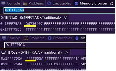

fCalTemperature_DegreeCelsius = (((130.0f - 30.0f) / (TEMP130_CAL_ADDR - TEMP30_CAL_ADDR)) * (ADC_TempReading - TEMP30_CAL_ADDR)) + 30.0f;The problem is that in memory the values don't seem to be correct:
I'd appreciate any help.

The TS_CAL1 and TS_CAL2 values are *halfwords*, so if the above display is the usual little-endian, TS_CAL1 is 0x0407 and TS_CAL2 is 0x055A.
If TEMP130_CAL_ADDR and TEMP30_CAL_ADDR are the *adresses* [EDIT] they are not, see below [/EDIT], then you have to dereference them (i.e. make the compiler to actually *read* from those addresses), i.e. instead of TEMP30_CAL_ADDR use *(uint16_t *)TEMP30_CAL_ADDR and similarly for the other one.

Your code should work, despite some misunderstandings in how things are stored.
These will be evaluated to 0x407 and 0x55A, so they're values not addresses.

The data sheet seems to relate to 30°C and 130°C - and not 110°C, as is cited in the code examples.
The ADC readings for temperature are in the range of 935-952 - which makes sense - 940 is lower than 30°C.
Our VREF is 3.3V (factor of 1.1 from 3.0V mentioned).
Without taking the 3.3V into account,
0x407 = 1031 (calibrated at 30°C)
0x55A = 1370 (calibrated at 130°C)
[(130-30) / (1370-1031)] * (940 - 1031) + 30 - I get 3°C.
I'm sitting in a room with 24°C, and the hardware is slightly warm - so this reading doesn't seem correct.
Am I missing something?

2021-06-13 1:29 PM
And then you did not factor it in...
[(130-30) / (1370-1031)] * ((3.3V/3.0V*940 - 1031) + 30 = 30.9
which is a quite reasonable value.
