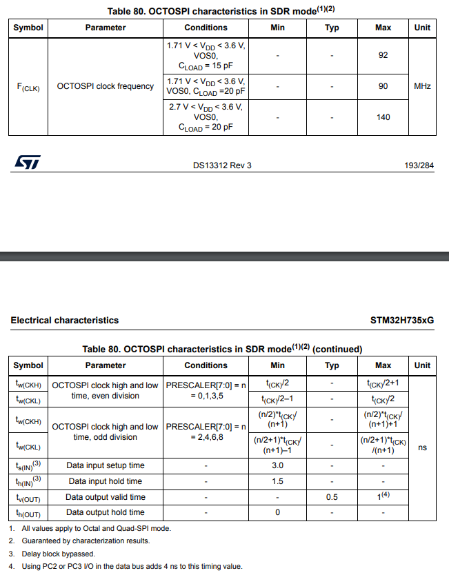

Hi @Saif ,
Thank you for sharing your request.
In fact the QUADSPI is an another way to configure your OCTOSPI peripheral.
So all the specifications applying to the OCTOSPI are true in case of QUADSPI configuration.
Please find in attached the datasheet and refer to the section 6.3.20 "Octo-SPI Interface characteristics" for more details.
