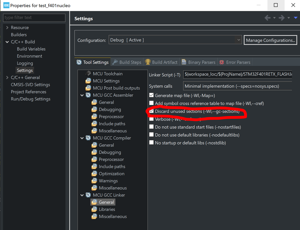

You can open up the map file and figure out what's taking so much space. Ensure your linker discards unused code (-WL,--gc-sections)

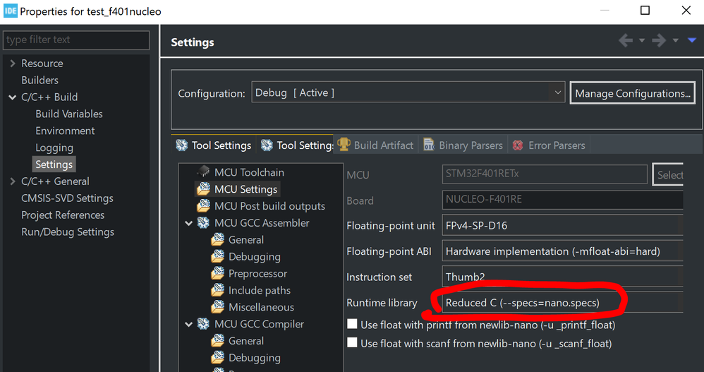

Use a reduced library such as nano (--specs).

Thanks for your answer TDK.
Where do I place (-WL,--gc-sections) and (--specs) in the cubeIDE settings.
2021-09-07 3:31 AM
In project settings.
