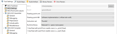

2023-08-30 12:50 PM
Sorry for bumping an old thread but this is exactly the problem I'm running into as well.
Device: STM32H563IIKx
I cannot attach the .ioc file because of the following error:
"The attachment command_module.ioc's application type does not match its file extension and has been removed." After three attempts, "The maximum number of attachments has been reached" even though each one was removed.
In reference to AScha.3's comment, I found that the "Floating-point ABI" selection was set to software, but there are no other choices in that drop-down. The "Floating-point unit" drop-down above it has no options listed:
According to the STMicro website, the 'H563IIK has a hardware single-precision FPU.
Needless to say, it's a bit of a problem that the STM32 Cube toolchain generates an unbuildable project...

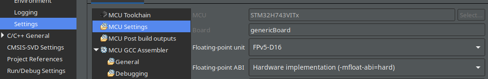

2023-08-30 12:52 PM
2023-09-08 8:23 AM
Note: The problem is in 1.9.0 and is resolved in 1.13.1. Unfortunately, trying to update from within 1.9.0 doesn't work; a problem that is discussed here.
