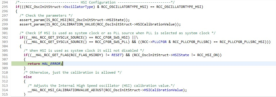

Developing code for STM32F427 I decided to use CubeMX. It was not the first time when I found the tool useful to start the project but the first time when I noticed a problem with the output configuration files, especially with RCC configuration.
Please find the following code into your main.c file:
RCC_OscInitStruct.OscillatorType = RCC_OSCILLATORTYPE_HSI | RCC_OSCILLATORTYPE_HSE; RCC_OscInitStruct.HSEState = RCC_HSE_ON; RCC_OscInitStruct.PLL.PLLState = RCC_PLL_ON; RCC_OscInitStruct.PLL.PLLSource = RCC_PLLSOURCE_HSE; RCC_OscInitStruct.PLL.PLLM = 8; RCC_OscInitStruct.PLL.PLLN = 180; RCC_OscInitStruct.PLL.PLLP = RCC_PLLP_DIV2; RCC_OscInitStruct.PLL.PLLQ = 3; if (HAL_RCC_OscConfig(&RCC_OscInitStruct) != HAL_OK) { Error_Handler(); }The function HAL_RCC_OscConfig returns with HAL_ERROR.
To run the program properly I had to remove RCC_OSCILLATORTYPE_HSI from the first line of the code above.That was the only modification. No more changes were made.

Is this a bug, or I did something wrong?

,This is a confirmed bug; It will be fixed througha patch which will be delivered soon.

,I would inform you that a new patch
/external-link.jspa?url=http%3A%2F%2Fwww.st.com%2Fcontent%2Fst_com%2Fen%2Fproducts%2Fdevelopment-tools%2Fsoftware-development-tools%2Fstm32-software-development-tools%2Fstm32-configurators-and-code-generators%2Fstm32cubemx.html
is now available on ST website. The issue is fixed.Khouloud.

Ok, this is now working. I got the same problem on F769NI after needing to try configuration with HSI.
The come back to HSE only was impossible and lead to fail during execution.It wasn't easy to recover solution in updated CubeMX (4.20.1). Needed to reconfigure to HSI again an go back to HSE.
With success this time.
