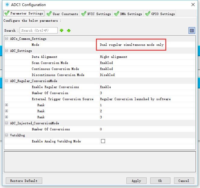

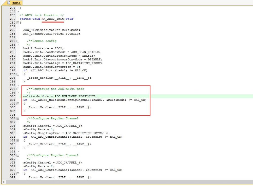

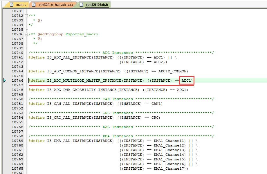

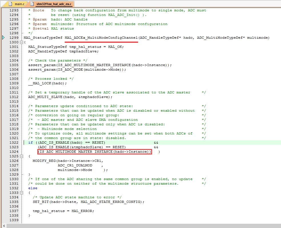

When I had generated code with dual ADC on regular simultaneous mode from STM32CubeMX, the code after compiled couldn't get to work and rised error handler, so I traced the problem, found that there is a multiple mode configure function in ADC init function, but the configure function only works with ADC1, here is the reason. and I will illustarte it below:
So, this code in ADC2_Init is meaningless, and bolck the program, I have to delete it everytime after I regenerated the project.
