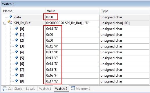

Here is the result of these functions;
As you can see, single byte read has returned
0x00
instead of
'D'
and multibyte array result has
shifted 3 bytes

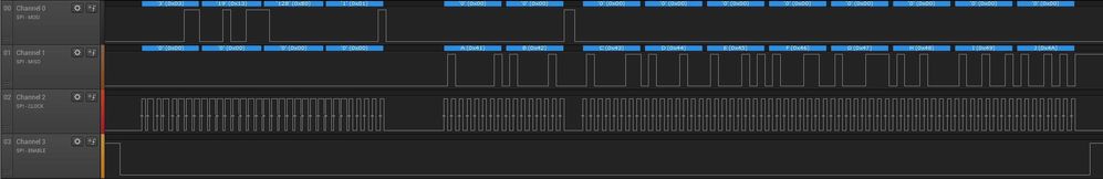

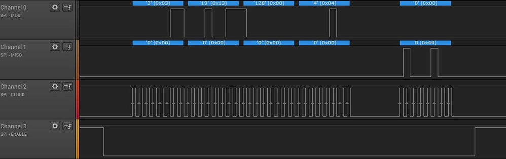

and 1st byte is corrupted. BUT, logic analyzer shows that signal on the SPI bus seems as expected. 0690X00000603B6QAI.jpg 0690X00000603BkQAI.jpg If I removed the
comments
on dummy 3 bytes read everything gets OK !

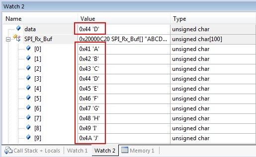

Adding 3 extra read sequence clocking bus for extra 3 bytes but it does not a problem for SPI flash, it just continue to out data by increasing its address. There is no any data except the written capital letters, so remaing 3 extra ouput data is 0xFF as expected. 0690X00000603B7QAI.jpg Now it seems OK but why do I need this weird approach ? Here is the SPI configuration data 0690X00000603BBQAY.jpg

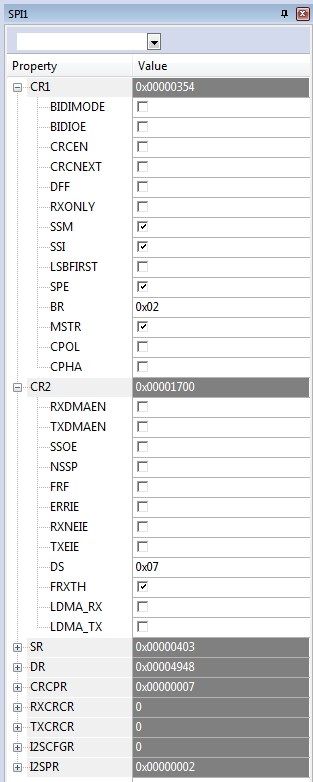

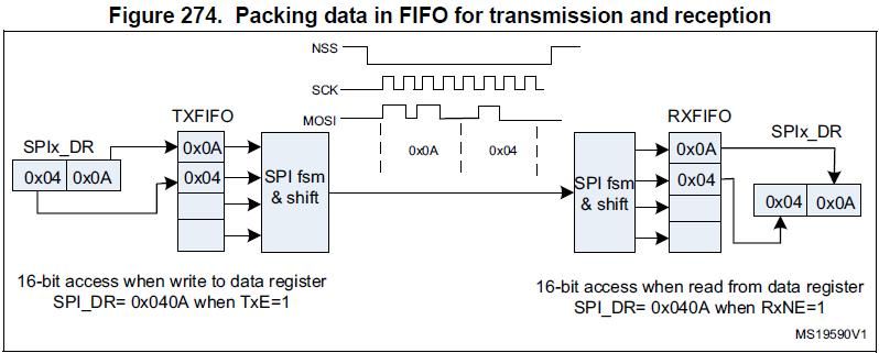

Is there a problem in CubeMx function that handling SPI data packaging described below ? Or any point that I am missing ? 0690X000006038IQAQ.jpg Best Regards
