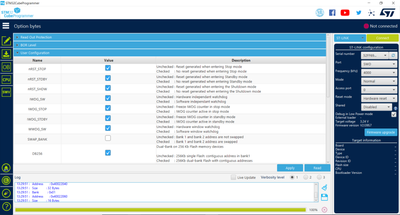

Check option bytes settings in STM32 Cube Programmer
2022-10-11 2:54 AM
Could you recommand any document regarding option bytes?
2022-10-11 8:41 AM
I cited the Reference Manual earlier, please start with that.
2024-02-07 12:24 AM
In the option Bytes Settings in STM32 Cube Programmer what should i check , it means which check box should i check ,I'm also facing same issue.
