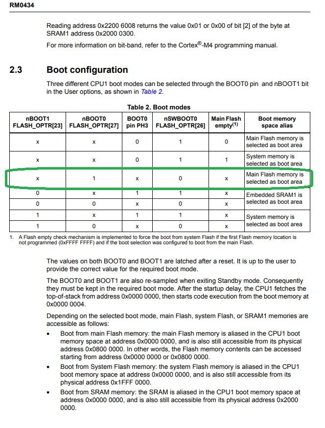

Suggests it's booting from ROM due to BOOT0 high/floating, or FLASH not containing valid image.
Make sure your code sets the vector table address properly via SCB->VTOR

Unfortunately, my board doesn't assigned the boot0 pin.
Because it is BGA pin, I cannot make any manual contact for it.

Perhaps there's a setting via the Option Bytes?

The JTAG/SWD works at a gate (flip-flop) level to access internal elements of the IC, via what was classically called scan-chains. The is unrelated to the USART, USB, SPI, I2C, CAN methods which are facilitated by code that is ROM'd into the product, providing software defined/controlled interfaces.
The BOOT state can be controlled via the Options Bytes in the STM32WB, see reference manual page shown in post above.

First, if I want to use SWD programming, Do I need boot0 pin to activate bootloader?
Second, I cannot see boot1 pin in my microcontroller STM32WB55VGY6TR. Do you know where is it?
