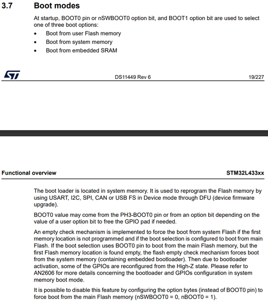

BOOT0 is shared with PH3, then based on code and option bytes ... read

Review Option Bytes per M&M
