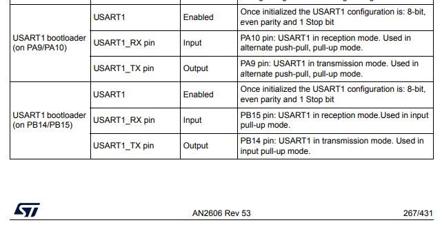

It should worked as described in the AN2606:
0693W00000LwQwuQAF.jpgMay be you should check if there is a remap of those pins.
