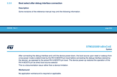

The issue was caused by the debugger as stated in the Errata sheet document.

2024-09-13 4:53 AM - edited 2024-09-13 4:54 AM
