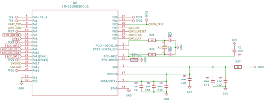

I have a custom board with an STM32U083KCU6 MCU - see schematics below
VBAT = +3.6V
I have 2 boards:
1. board: I flashed it via SWD but forgot to enable it in STM32CubeMX, which means that I'm not able to flash it again via SWD
2. Board: This time, I remembered to enable SWD inside STM32CubeMX and was able to flash it successfully. It worked fine for a long time, but now it suddenly seems like my ST-LINK V2 programmer is no longer able to flash it for some reason...
NRST is connected to RST on the ST-LINK V2 programmer.
I can use the same ST-LINK V2 programmer to flash a STM32U083 Nucleo board, so it does not seem like the ST-LINK V2 programmer is broken

Error: No STM32 target found! If your product embeds Debug Authentication, please perform a discovery using Debug AuthenticationI have soldered a wire between BOOT0 and VBAT, but am still not able to connect to it via SWD.
Note that the UART is working on board 1, and I am to receive messages from the MCU, which means it has power
Is there anything I'm missing to be able to flash it again via SWD, or what are my options?

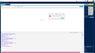

2025-06-23 9:38 AM
When using the STM32CubeProgramemr and setting the mode to "Under reset". I receive the following error
2025-06-24 12:00 AM
Yes, but to do this you need access via the SWD interface.
