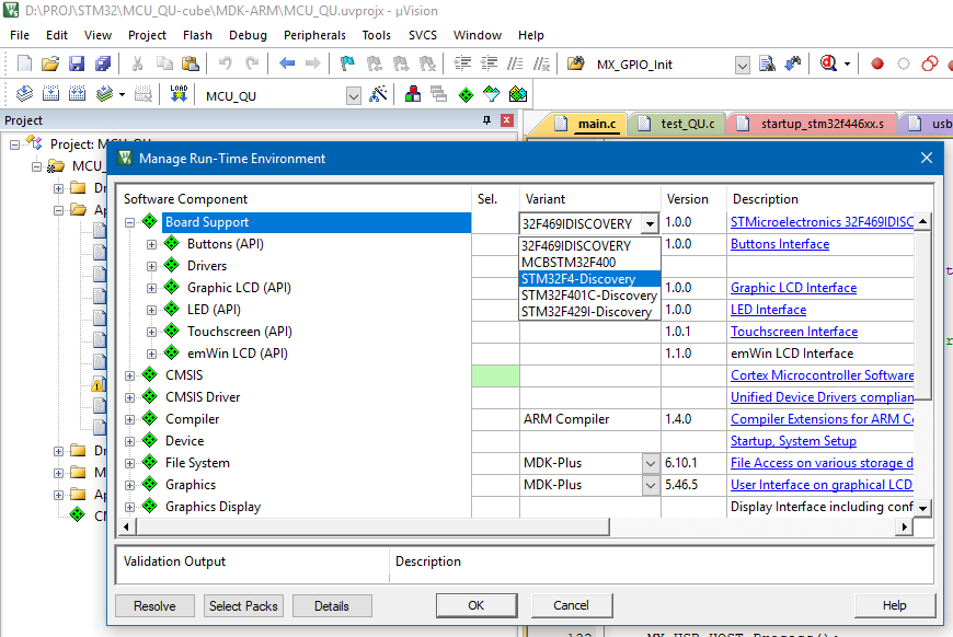

@OP Since you have a ST eval board and Keil, the Keil's DFP should have something that they call "Board support" for that board:
This is all they have to offer. Basically they take this from demo software provided by ST,
but present in nice form with components and checkboxes.

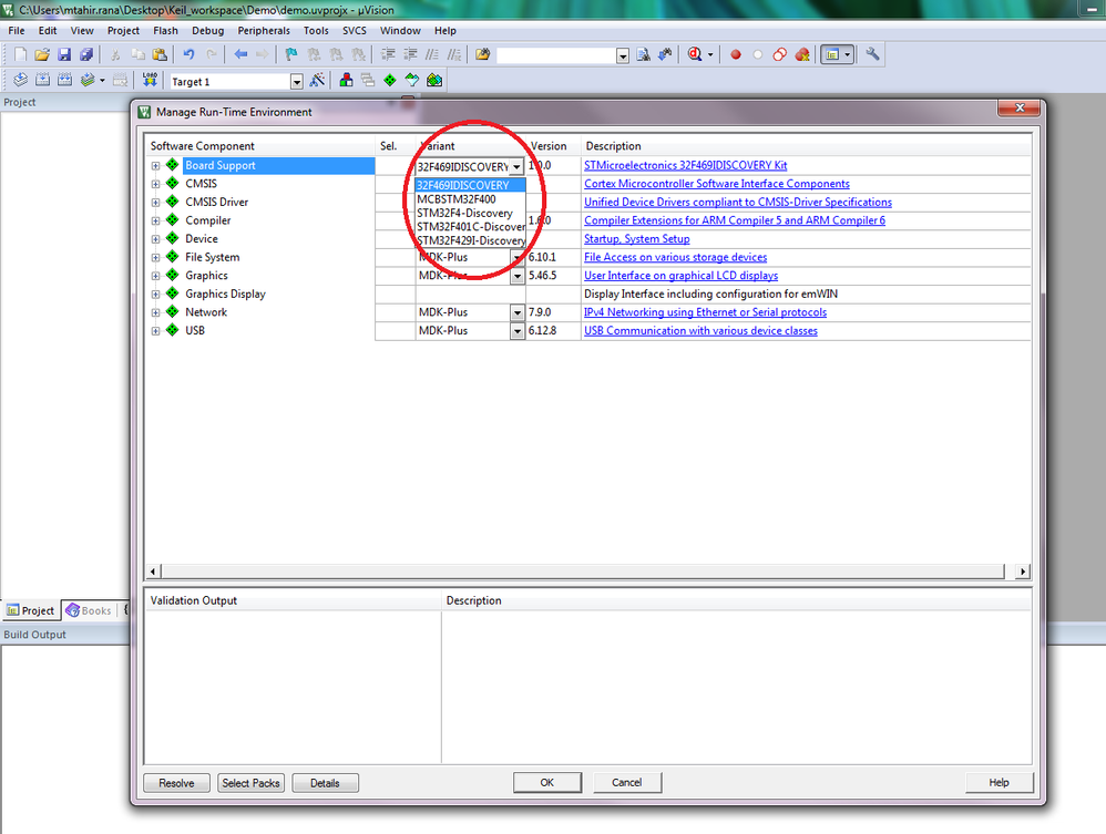

2018-09-28 12:15 AM
@Pavel A.
Here is the photo, while I was staring the project. Although I could select the chip in the previous step, but I was not able to locate the board I am working with. That's why I was talking about *.bsp files. May be I am wrong. How will we be adding board support in our project, or we dont need that at all? Please see the picture below:
2018-09-28 1:01 AM
The STM3240G is an older eval board, the docs state 2011 as initial release.
You might check with the current Keil version if it is still supported (with DFPs). Perhaps at their forum.
2018-09-28 1:47 AM
@Community member
Yes sir, DFPs for the chip are supported, but the board is not supported( so far :) )
