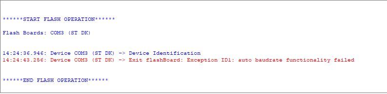

I can’t program my STEVAL using SWD neither UART right now.
My last FW only configures my accelerometer an them goes to SHUTDOWN.
When the MCU is on SHUTDOWN mode I could never program STEVAL using SWD (in Keil or using BlueNRG-X-Flasher Utility), but UART worked.
Error in Keil
Error in BluenRG-X-Flasher Utility

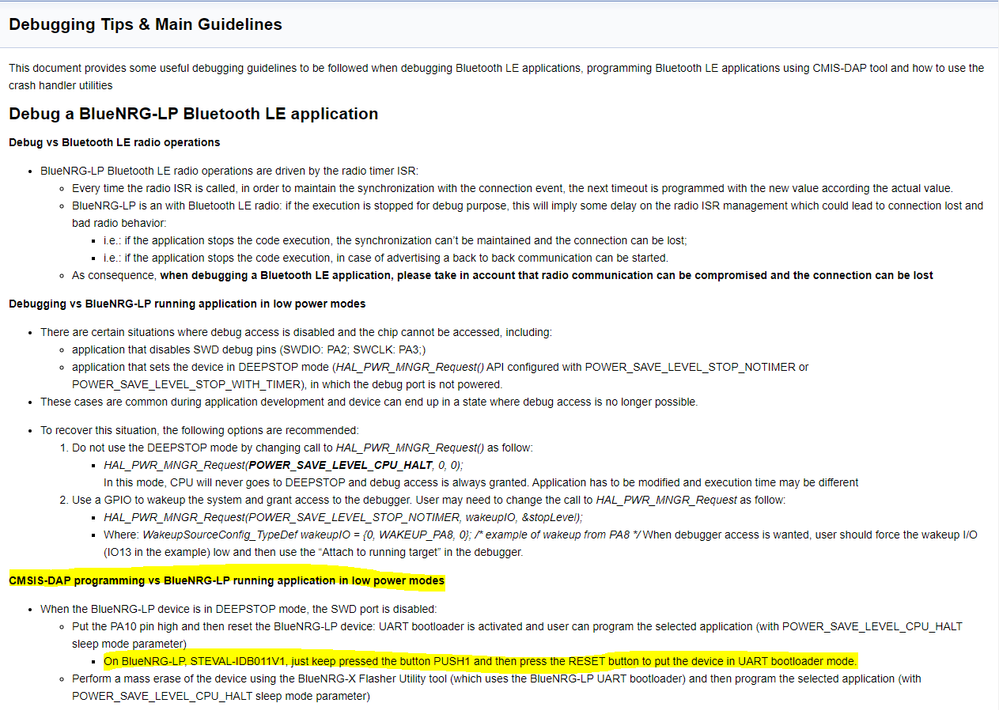

Hi @Adrian Ramírez Mengana ,
Solution given by @Nikhil Gayke is the right one.
FYI, let me share full explanations here below - extracted from BlueNRG-LP SDK documentation "Debugging tips"
Regards,
Sebastien.
