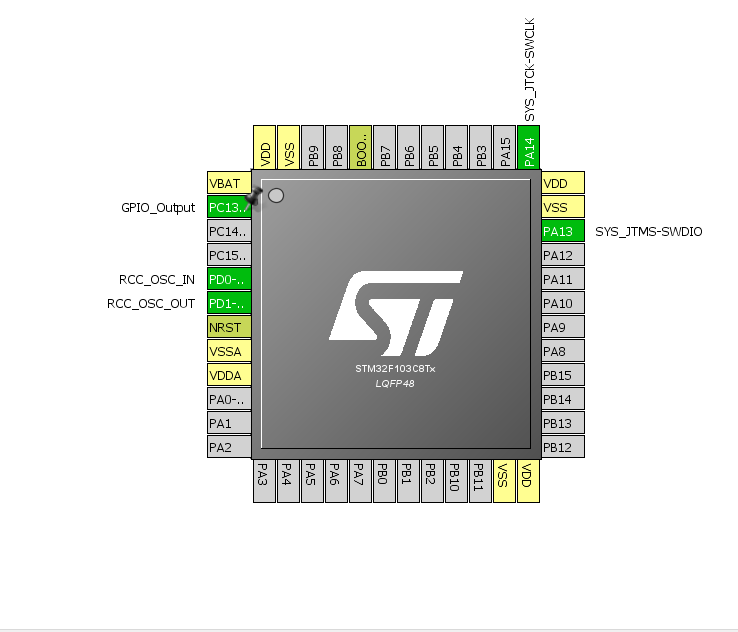

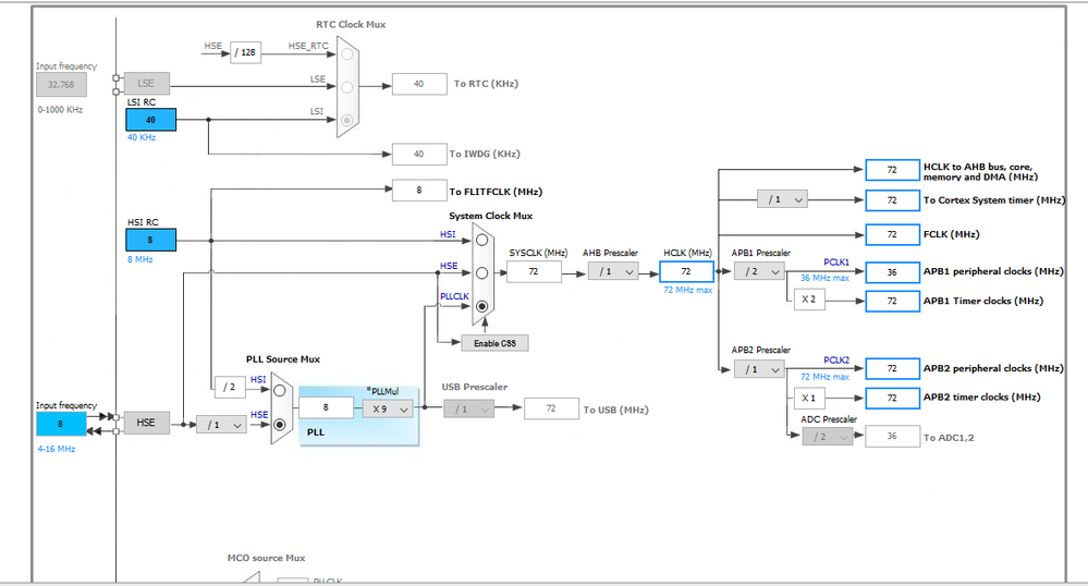

I'm using stm32 cubemx with keil 5 to program simple blink on stm32f103c8 bluepill board with stlink/v2 i have configured pins RCC SYS and GPIOC 13 as output with 8 Mhz input frequency and HCLK is 72 MHz when I download code code from keil nothing happens led does not blink and it shows 1.8v at PC13 pin, please help me to figure out what I'm doing wrong.

2017-04-11 3:30 AM
Hi
aniket5941
,A new patch
/external-link.jspa?url=http%3A%2F%2Fwww.st.com%2Fcontent%2Fst_com%2Fen%2Fproducts%2Fdevelopment-tools%2Fsoftware-development-tools%2Fstm32-software-development-tools%2Fstm32-configurators-and-code-generators%2Fstm32cubemx.html
V 4.1is available to fix this issue, you can create new project and check to have the correct RCC configuration.As you are using an old .ioc project, you should first EDIT the .ioc file and REMOVEthis line (remove the RCC.OscillatorType that you don't need)
RCC.OscillatorTypeHSI=RCC_OSCILLATORTYPE_HSI
Then re-generate the project, this will resolve your problem.
Best Regards
Imen
2017-04-11 5:30 AM
