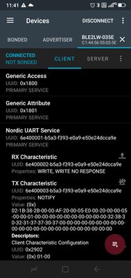

This screen shows the notification received by Nordic MCU-based devices (complete).

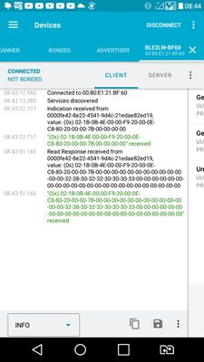

This screen shows the Nordic app log. At 08:43:22 the notification was recorded (20 bytes). At 08:43:51 the message is recorded after clicking the down arrow (read with 62 bytes).

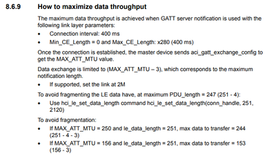

Imen.D
Hello @Wiliam,
Is there a way to change the size of the notification (let's see, the notification, not the payload itself) or is it a feature of the BLE-SIG stack implementation to transmit notifications up to 20 bytes?
I advise you to have a look at the AN5289, on how to maximize data throughput.
Imen
