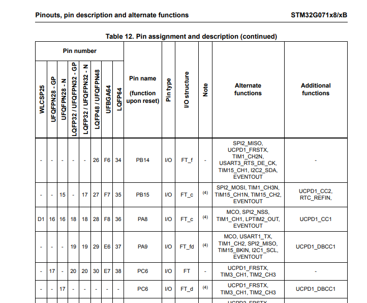

Associate II
On STM32G071CBU6, when PB15 is used as CC2 with DBCC2 shorted to CC2, does the ROM bootloader ever drive PB15 as SPI2_MOSI, or does the CC/dead-battery own the CC2 pin and that path always takes priority?
This detail is critical for our design because the device is bus-powered and relies on the dead-battery path to manage initial power-up. If the bootloader were to override PB15 and drive it as SPI2_MOSI while the flash is blank, it could cause a power drop when the ROM bootloader starts.
I checked the datasheet, reference manual, programming manual, and bootloader manual, and none of them explicitly state how the ROM bootloader handles SPI2_MOSI when that pad is also CC2 with DBCC shorted.

Also, does your device have a USB-C receptacle or does it have a fixed-attached USB-C cable ("pigtail") ?  Since if you have a receptacle then you need both CC1 and CC2, and DBCC1 (PA9) is actively driven high by the bootloader so that would be a fatal problem.
Definitely the safer options would be to either use UCPD2 instead of UCPD1 (since its pins don't have bootloader conflicts) or avoid using the ROM bootloader for in-the-field firmware upgrades and e.g. use a custom bootloader instead.

This is where I’m confused: I can convince myself that when DBCC2 sees a high level, some internal mux could somehow block SPI ownership of the CC2 line, but I can’t explain how DBCC1 would take priority over USART_TX, especially when it is in pull-up mode (how does it detect this scenario?). Maybe it checks the voltage before enabling the pull-up? So what you mentioned about both the 25k pull-up and the 5.1k pull-down being active at the same time does make sense.
According to the datasheet, DBCC pins should either be grounded when UCPD is not used or shorted to CC when UCPD and dead-battery mode is required. In those two configurations, the bootloader using USART1 is effectively impossible (USART RX is either shorted to ground or to CC). The only remaining scenario is using UCPD without dead battery, in which case there seems to be no way to reserve CC1 and prevent the bootloader from taking it as USART_RX. That’s why I’m totally confused.

Whats on the pins, see in ds of cpu ; even before program or bootloader starts, pins can have a function,
here -> function upon reset :

Then I don't see how this is going to work (when using UCPD1) since the bootloader will configure PA9 (UCPD1 DBCC1) as USART1 TXD which will drive it high, which will definitely overrule the 5.1k pulldown on PA8 (UCPD1 CC1).
I performed some testing today, and the board powers up correctly and remains powered in both USB-C orientations. To simulate first time flashing on a blank device, I performed a mass erase. I am not sure if this is equivalent to a truly blank MCU out of the factory, but even after mass erasing, the board still powers up in both orientations.
Are you sure the power source you're using monitors the CC pins and only supplies VBUS when it detects a sink attached, instead of just providing VBUS continuously? Officially the latter is only permitted as a result of using a legacy USB charger/port with a USB-A-to-USB-C cable and any proper USB-C power source (charger or USB port) is required to dynamically control VBUS depending on the CC pins, but I have no doubt some USB-C chargers will simply ignore the USB-C specifications and always power VBUS.
This is where I’m confused: I can convince myself that when DBCC1 sees a high level, some internal mux could somehow block SPI ownership of the CC1 line, but I can’t explain how DBCC2 would take priority over USART_RX, especially when it is in pull-up mode (how does it detect this scenario?).
The DBCC1/2 pins are only relevant while the STM is powered off, in which case >1V on a DBCC pin activates the 5.1k pull-down on the corresponding CC pin. If the STM then powers on, this state is latched and the 5.1k pull-down remains active until explicitly deactivated by software, the DBCC pin is no longer relevant at that point.
I don't know how the GPIO configuration interacts with the 5.1k pull-down, but control over that pull-down is completely separate from the GPIO configuration registers so it seems plausible that it may simply remain connected regardless of GPIO configuration.
In case of CC2 (PB15), if its 5.1k pull-down indeed remains enabled (instead of, or in addition to, the 20-55k pulldown on that pin configured by the bootloader via the GPIO config) then it will mostly override the 20-55k pull-up on DBCC2 (PA10 / USART1 RXD) that's connected in parallel (since they're externally tied together).
I can avoid using the ROM bootloader for in-field updates, but the MCU will still boot into the ROM bootloader the very first time when the flash is blank. If all of our assumptions are correct, then a blank, bus-powered device using UCPD1 with dead-battery support might only power up in one orientation (which isn't too bad) as the CC voltage would be marginal.
The CC2 voltage would be marginal, while CC1 will be driven to 3.3V, so it will work in only one orientation and even then be marginal. But if this is just for factory flashing, just use a USB-A-to-USB-C cable to power the device and it will work just fine since then the CC pins are simply ignored anyway.
